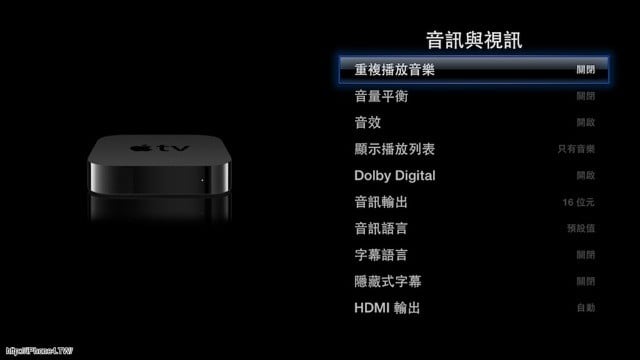

    之前在Apple TV上要用XBMC來播放有AC3/DTS 5.1聲道的影片,都無法正常輸出來,找了一下網路的解決方法,終於解決囉!
    只要在XBMC上設定
    Audio Output: Optical/COax
    Speaker Configuration : 5.1
    Boost Voume level on downmix: Check
    Dolby AC# capable receiver : Check
    DTS capable Receiver : Check
    Audio Output Device: Default
    Apple TV settings:
    Dobly Digital : On
    Audio Output: 16 bit
